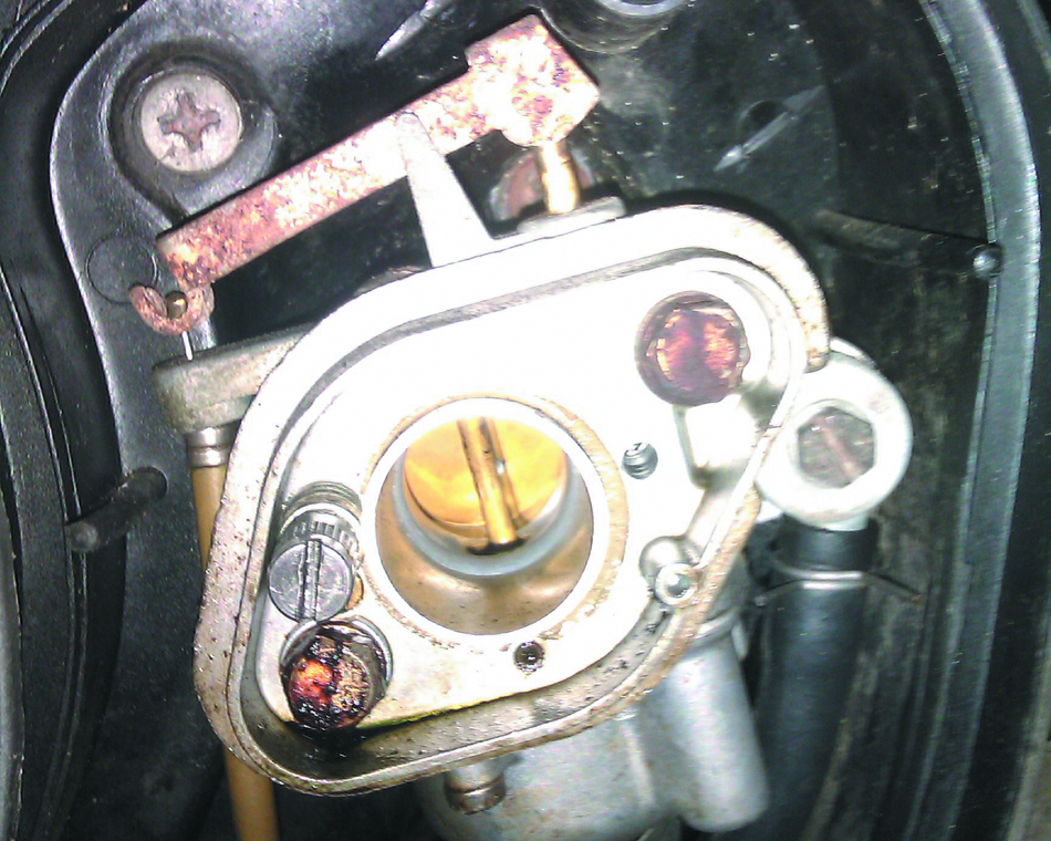

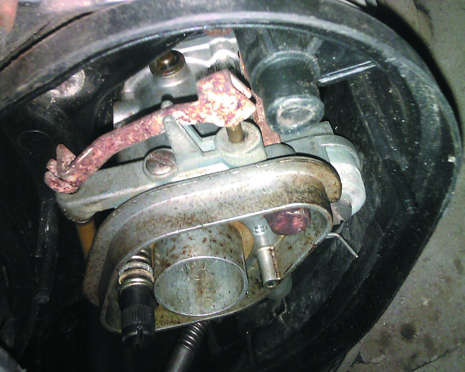

DELORJO (好像不是英文)
MADE Italy
編號 FHBA 28 20
感謝 :faint:
24.jpg [ 1003.76 KiB | 被瀏覽 13915 次 ]
142.jpg [ 972.4 KiB | 被瀏覽 13915 次 ]
I'm convinced that the only thing that kept me going was that I loved what I did

tbj 寫:
DELORJO (好像不是英文)
MADE Italy
編號 FHBA 28 20
感謝 :faint:
是DELLORTO......它確實不是音文...
油嘴我有................ :XD: :XD: :XD:
我還有幾樣PKV的東西...妳要嗎???

看化油器狀況車主可能少DIY,如果是這樣這台車別搞了,阿昌你覺得哩

12MAN 寫:
搞這車要很有愛心....... :runcry: :runcry: :runcry:
